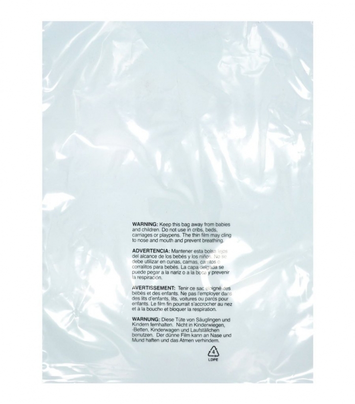

Let’s take a look at the most applicable requirements: All state and city requirementsfor suffocation warning apply to plastic bags with a thickness of less than one mil(1/1,000) inch. This is because thin plastic is more flexible and can easily cling to andform an airtight seal around a child’s nose and mouth.

塑料袋上面的警示语!
