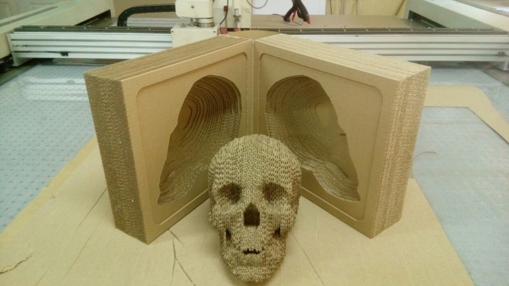

请教楼主,这个是怎么做的呀?是先建3D模型,然后切片吗
签到天数: 174 天
109
1093
 楼主| 发表于 2017-7-2 22:32:18 | 显示全部楼层

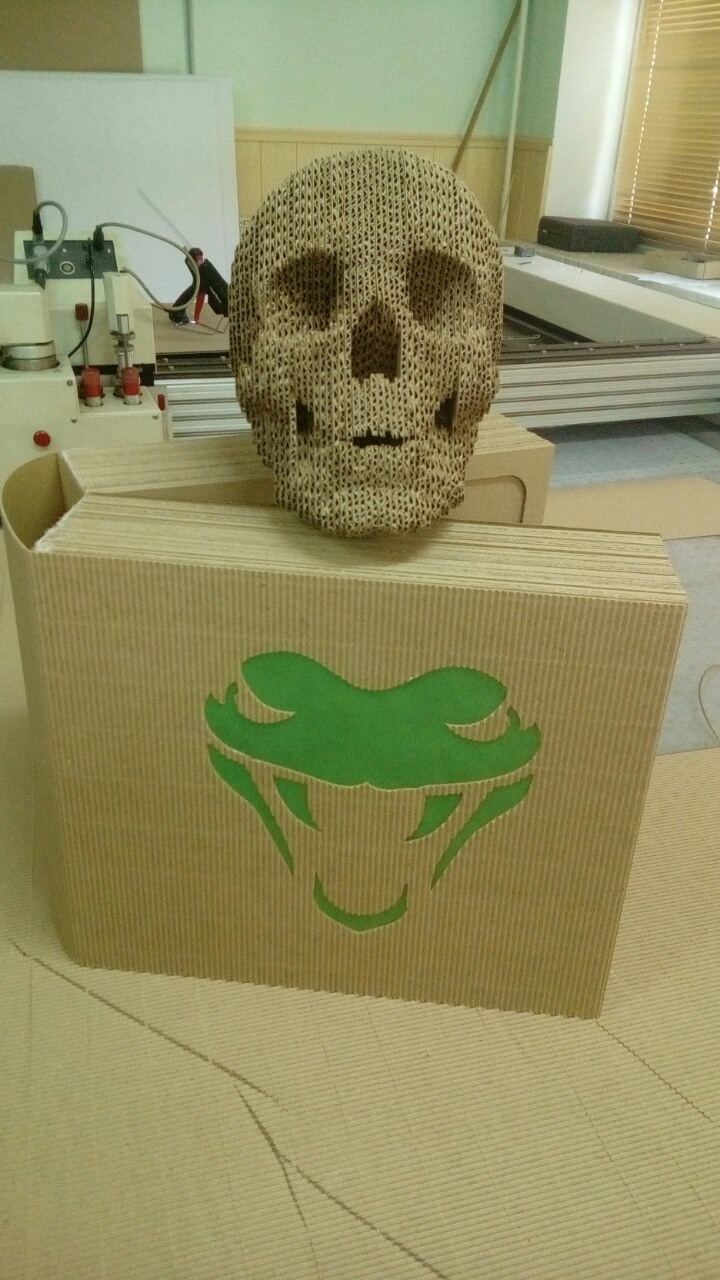

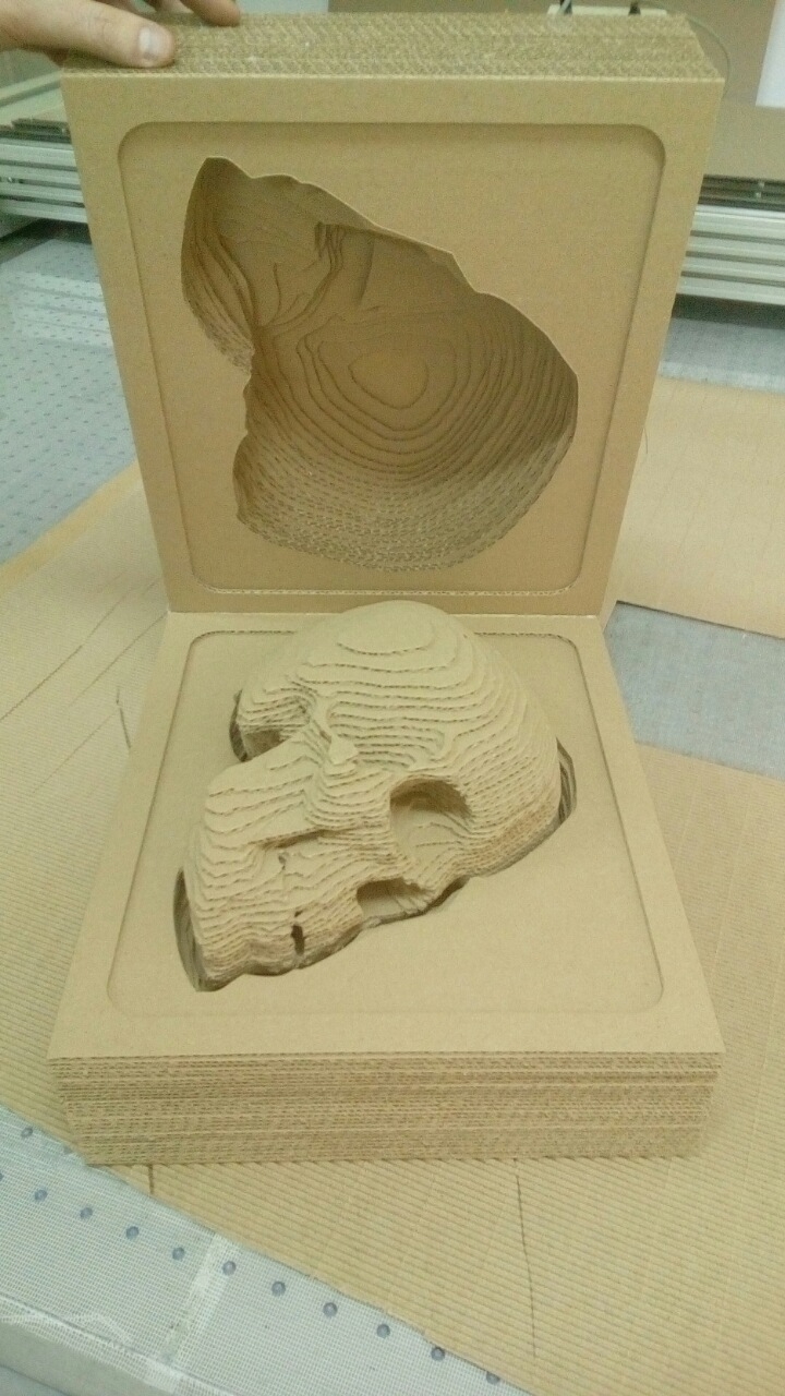

1. To cut out from a corrugated cardboard B
2. To stick together separately each half of a skull together with the book (at gluing together of sheets not to divide a product).
3. to cut out a book cover from a two-layer corrugated cardboard E.
4. In each half to separate a skull from the book.
5. To stick together two halves of a skull.
6. To paste to two halves of the book a cover previously having enclosed a background on a snake.
Excuse badly I know English if not clear I can make the scheme of assembly.

Yes. the 3D model is cut on layers.
