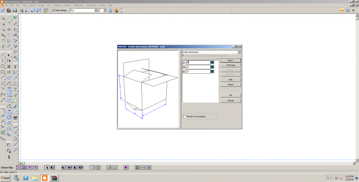

发表于 2016-3-5 19:42:00 | 显示全部楼层
Remarkable

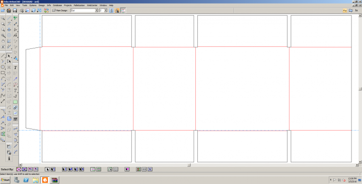

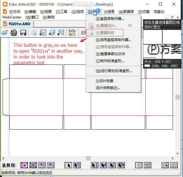

Recently I focus on the StyleMaker function, and there is a question,could you help me?
The question is, I can't open the attachment file properly for it has not extension filename.Could you tell me how can I open it properly? Thanks
f0201w.rar
6 KB, 下载次数: 25, 下载积分: 迷币 -2
A file without extension filename

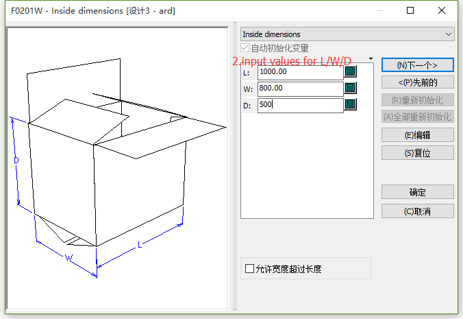

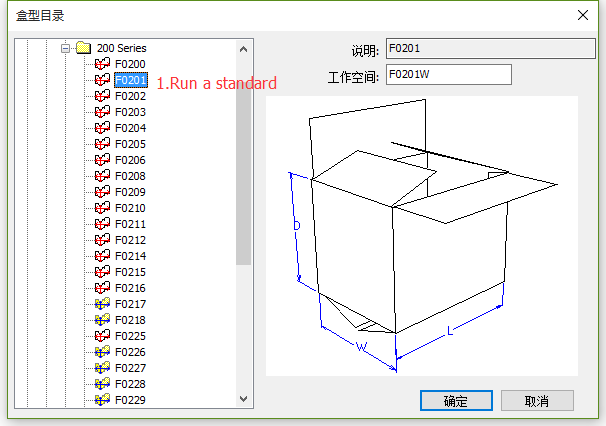

 楼主| 发表于 2016-3-5 20:08:16 | 显示全部楼层
wolfshawn 发表于 2016-3-5 19:42
Remarkable
Recently I focus on the StyleMaker function, and there is a question,could you  ...

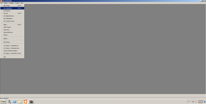

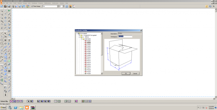

that file is an esko library standard.
It's FEFCO 0201 standard
It's stored inside C:\Esko\Artios\ArtiosCAD14.1.3\InstLib
you open it by selecting File > Run a Standard
you configure the board, the variables, etc. and it will open.
cheers
-s

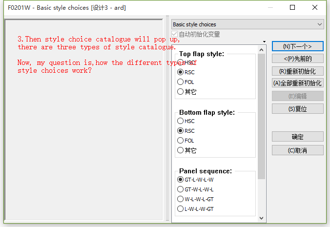

发表于 2016-3-5 20:38:04 | 显示全部楼层
First of all, thanks for your reply
I'd like to read the history order, to find how the style choices works.
But I failed to open the history file, so I copy the"f0201w" file to analyze what kind of order in it

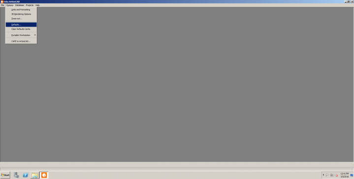

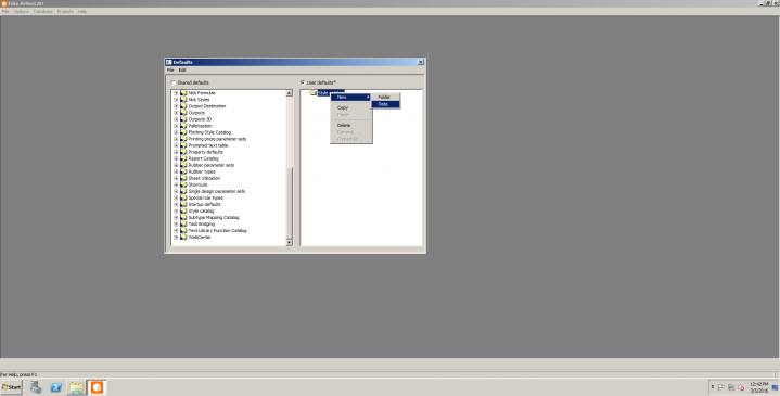

 楼主| 发表于 2016-3-5 20:50:01 | 显示全部楼层

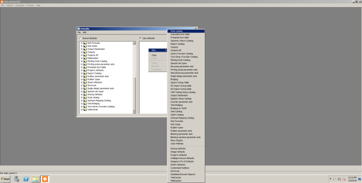

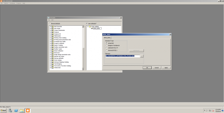

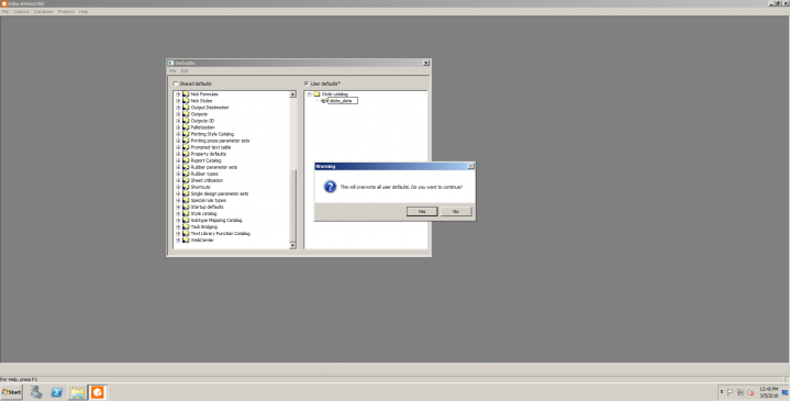

To use one of these designs as standard:
1 - save it inside C:\Esko\Artios\artioscad14.1.3\serverlib\cn
2 - go to Options > Defaults...
3 - right click on User Defaults and select New > Style Catalog
4 - right click on your new style catalog and select New > Data
5 - double click on your new data and associate the file you saved in C:\Esko\Artios\artioscad14.1.3\serverlib\cn
6 - close and save the user defaults
7 - go to File > Run a Standard and use your new custom standard.
cheers
-s

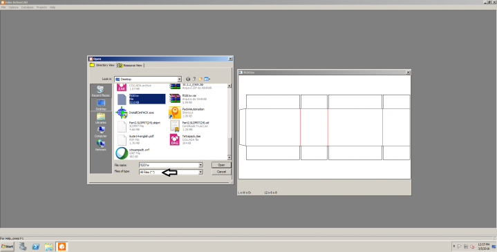

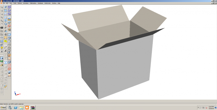

 楼主| 发表于 2016-3-5 21:00:15 | 显示全部楼层
I'd like to read the history order, to find how the st ...
you can open that file without extension directly in ACAD.
go to File > Open, select 'All Files (*.*)' and select the f0201w file to open it.
cheers
-s

Dear brother,
Thanks for your time and patient,and in fact, I'd like to know the parametric text in it.
But the " replay rebuild" button is gray.
签到天数: 17 天
248
3233
3088
发表于 2016-3-5 23:58:28 | 显示全部楼层
Or may I put my question in this way: how the three types of style choices work in "f0201w".
It has confused me for a long time.
